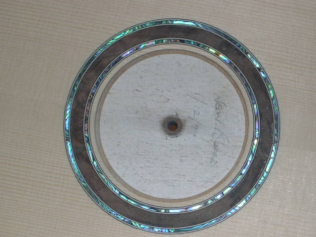

If I wanted to do a rosette like the one in the picture below, would I have to cut my own abalone? I have cut my own abalone curved strips for a single rosette circle many times, but it is very time consuming. Lately I've been buying my curved rosette pieces pre-cut. I just don't know of anywhere that sells them with a different inner radius. Anybody got any ideas?

Yes, I have ordered from Andy Depaule before. I figured it would be at least a four week turn around for custom cut radiuses. I may end up cutting them myself from solid shell. It just seems to take a while.
Has anybody tried buying the curved Abalam (laminated shell) strips and breaking them so they would fit into different radiuses?? I understand this stuff breaks much better than solid shell.

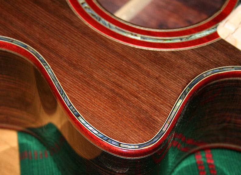

I do all my abalone purflings from real shell and have no problem breaking them into tight curves.

How do you get such a nice radius on your bindings?
PostPosted: Fri Dec 22, 2006 1:50 pm
[QUOTE=rich altieri] Peter
How do you get such a nice radius on your bindings?[/QUOTE]
I could tell you but then you know what I would have to do to you?
PostPosted: Fri Dec 22, 2006 2:46 pm
Rich,
there is no radius....

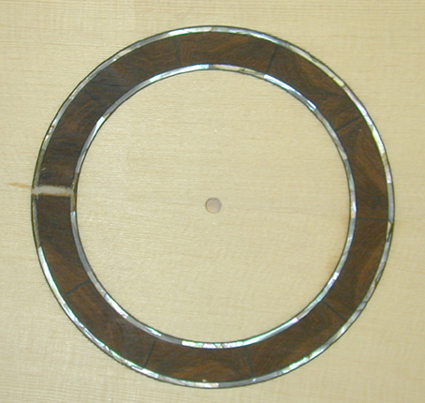

Std rosette radius shell will work fine - I did this one with .063 curved red ab from MOPsupplies, same radius inner and outer ring .. it just snaps in. Wood is braz rw bookmatch segmented. Soundhole will be 4 inch.
PostPosted: Wed Dec 27, 2006 6:19 pm
Thanks Tony! Nice rosette!
Colby -- perhaps this thread is too dated for you to respond but is that a picture of a Kinnaird Rosette? Anthony Z39079.0981365741
